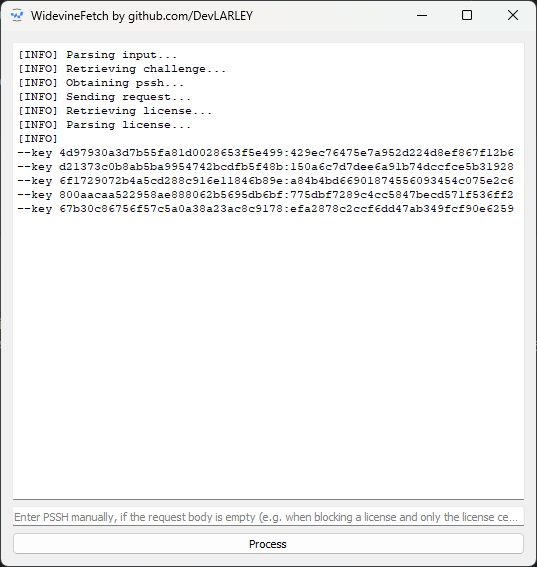

Hi all,
this is WidevineFetch, a program that just requires a 'Copy as fetch' input (and an L3 CDM of course) and nothing else.
What it does:
The program will parse the given input, and extract the Request URL, headers and body.
It will locate the license request inside of the JSON (if it's not just bytes), extract the PSSH, generate a new license from that PSSH and replace it.
It will also extract the license from the response, if JSON.
The PSSH has to be entered manually if the service doesn't send the license request (just the first request) when blocking the URL (can be seen on the last service in the demo video).
A demo video is available here (or just on the GitHub page, as well as installation and usage instructions).
Finally, no more custom scripts (mostly).
Hope you like it.

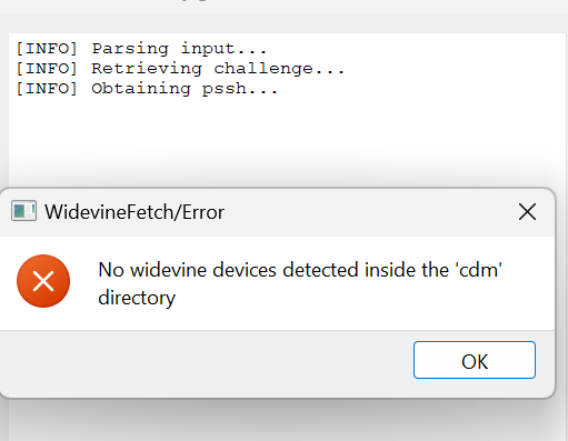

thank you for this new guesser, but i've put my cdm on cdm folder but the guesser can't find cdm ...
what's wrong ?Last edited by whs912km; 1st Aug 2024 at 17:15.
That's such a PyCharm issue. I had my 'cdm' folder in the same dir as the python file, but then decided to move all of it to a separate folder as there were some other files inside the project directory (except the 'cdm' folder). The problem is, PyCharm just silently refactored the code without me knowing.
Bypass HMACs, One-time-tokens and Lic.Wrapping: https://github.com/DevLARLEY/WidevineProxy2 -
That has been fixed, see the updated file on GitHub.

The script has been updated, so you don't have to paste anything anymore, just click process. This also lead to Discovery+ and Zee5 (and surely many others) working, as the QTextEdit box wasn't taking non-breaking spaces (0xa0).
The TextEdit box is now locked, so you can't edit its text and the font has been set to a monospaced font, so the keys will be displayed currectly with the new window start-size.
Be sure to also install the updated requirements.txt file, as it was changed too.
[Attachment 81152 - Click to enlarge]Bypass HMACs, One-time-tokens and Lic.Wrapping: https://github.com/DevLARLEY/WidevineProxy2 -
